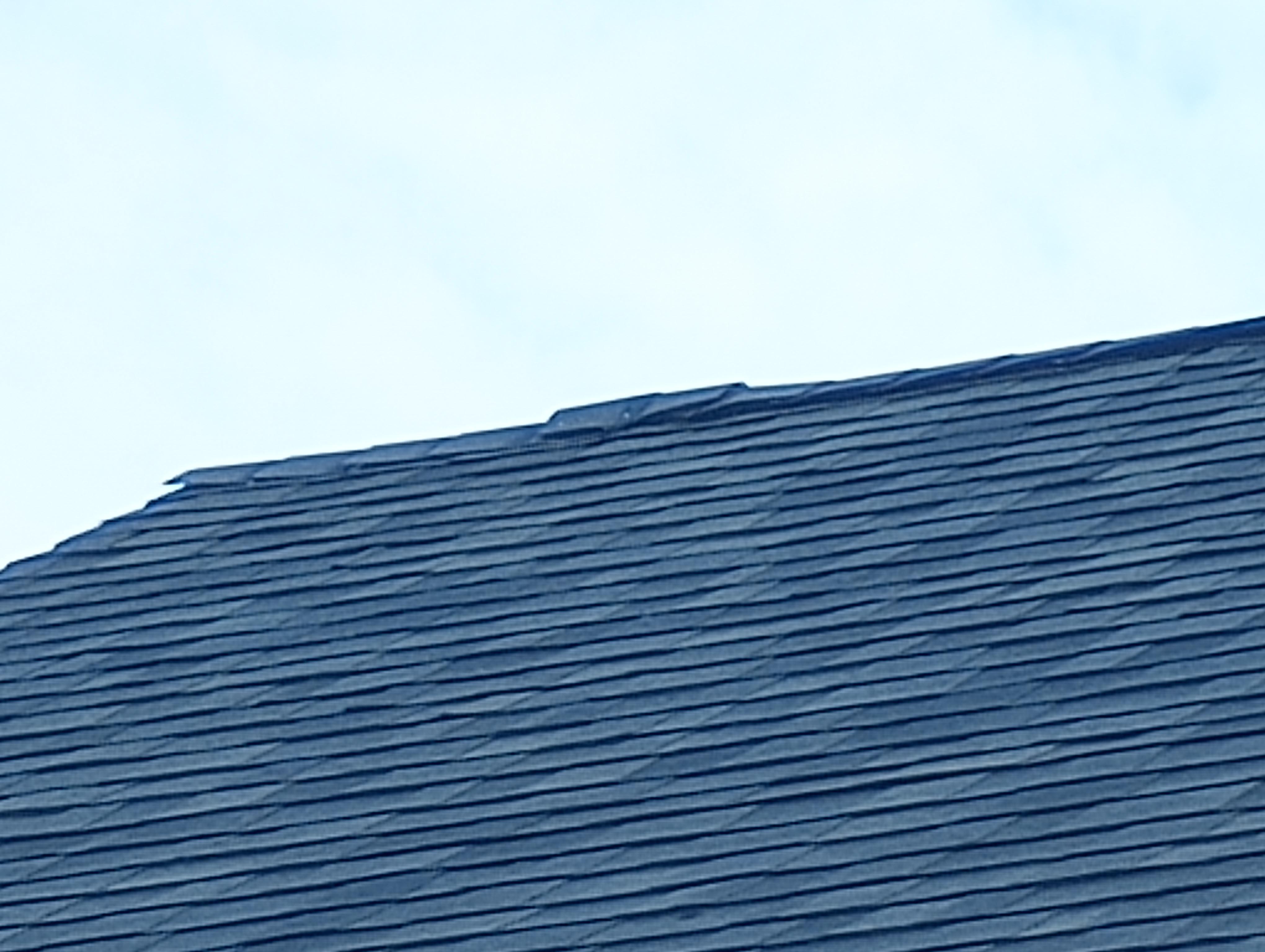

Came home from work yesterday, and this is what I saw for ridge workmanship. It's my first new roof as a first-time homeowner, but this does not look right to me. Roofer dismissed what I described as it not looking "clean" (especially towards left side) as related to cold weather. I'm not so certain? Hoping for some advice so I can speak up before the job is finished, thanks.

Definitely not clean work!!!
Typically they would cut one in half being the last one and either tar it or adhesive on to ensure the look is clean, and water tight with no exposed fasteners.
