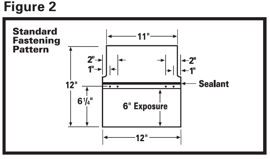

Nail Placement on Owens Corning ProEdge Hip and Ridge
September 5, 2024 at 6:43 a.m.
Keenbeen
I was surprised that the manufacturers recommended nail pattern is outside the sealant and only 1/4" from the exposure.  There is probably a good reason, but for the life of me, I cant figure it out.  I was hoping someone could explain.
