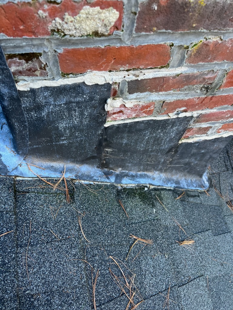

I have a friend who had his roof shingled within the last couple of years. It is leaking around the chimney and he is asking my help. I can't see anything obvious. The only thing that seems unusual to me is the lead flashing on the chimney sits on top of the shingles not under them. Is the way it is done? Please help educate me. Thank you.

I can’t really tell from the 1 picture, if you had a couple more it might help. The problem can be multiple things.
  1.  If there are nails holding the lead down, they could be leaking.
  2. If the caulking at top is not sealed to brick and lead properly, that could be leaking.
  3. The back of the chimney lead is also on top of the shingles, which will allow water underneath and will cause a leak.
The recommended action is to remove the flashing and shingles around the chimney and do a rework with Aluminum Step and Cap/Cover Metal.

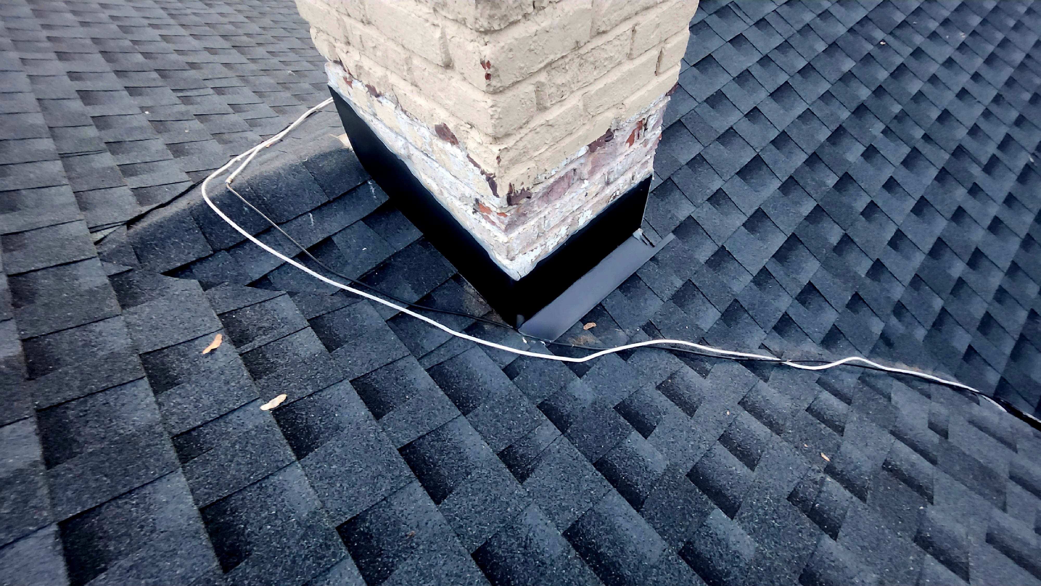

See attach picture for an example.
Notice how the metal at the low point of the chimney is the only exposed metal on the roof and there are no nails exposed.
